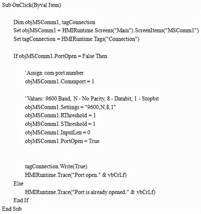

(一)打开端口
(1)代码图片
(2)VBS代码
Sub OnClick(Byval Item)
DimobjMSComm1, tagConnection
SetobjMSComm1 = HMIRuntime.Screens("Main").ScreenItems("MSComm1")
SettagConnection = HMIRuntime.Tags("Connection")
IfobjMSComm1.PortOpen = False Then
'Assign com port number
objMSComm1.Commport= 1
'Values: 9600 Baud, N - No Parity, 8 - Databit, 1 - Stopbit
objMSComm1.Settings= "9600,N,8,1"
objMSComm1.RThreshold= 1
objMSComm1.SThreshold= 1
objMSComm1.InputLen= 0
objMSComm1.PortOpen= True
tagConnection.Write(True)
HMIRuntime.Trace("Portopen." & vbCrLf)
Else
HMIRuntime.Trace("Portis already opened." & vbCrLf)
EndIf
End Sub

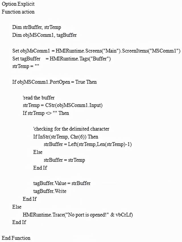

(二)读Buffer
(1)代码图片
(2)VBS代码
Option Explicit
Function action
DimstrBuffer, strTemp
DimobjMSComm1, tagBuffer
SetobjMsComm1 = HMIRuntime.Screens("Main").ScreenItems("MSComm1")
SettagBuffer =HMIRuntime.Tags("Buffer")
strTemp= ""
IfobjMSComm1.PortOpen = True Then
'readthe buffer
strTemp= CStr(objMSComm1.Input)
IfstrTemp <> "" Then
'checkingfor the delimited character
IfInStr(strTemp, Chr(6)) Then
strBuffer= Left(strTemp,Len(strTemp)-1)
Else
strBuffer= strTemp
EndIf
tagBuffer.Value= strBuffer
tagBuffer.Write
EndIf
Else
HMIRuntime.Trace("Noport is opened!" & vbCrLf)
EndIf
End Function

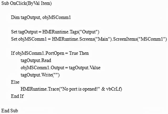

(三)发送数据
(1)代码图片
(2)VBS代码
Sub OnClick(ByVal Item)
DimtagOutput, objMSComm1
SettagOutput = HMIRuntime.Tags("Output")
tagOutput.Read
objMSComm1.Output= tagOutput.Value
tagOutput.Write("")
Else
EndIf
End Sub

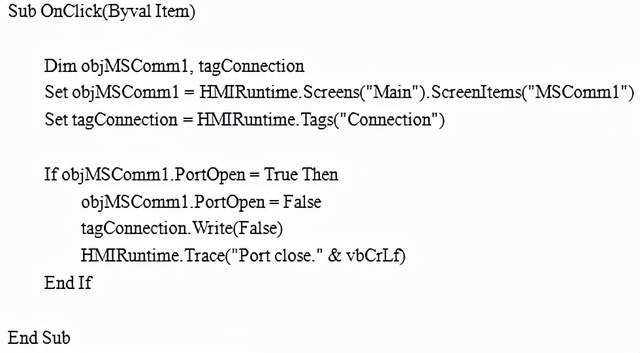

(四)关闭端口
(1)代码图片
(2)VBS代码
objMSComm1.PortOpen= False
tagConnection.Write(False)
HMIRuntime.Trace("Portclose." & vbCrLf)
EndIf
End Sub
