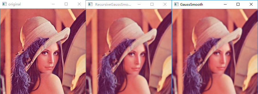

int main(int argc, char *argv[])
    Mat src = imread("../RecursiveGaussian/lena.bmp", 1);
    imshow("original", src);
    Mat dst;
    RecursiveGausssmooth2D(src, dst);
    imshow(" RecursiveGaussSmooth", dst);
Mat dstImage;
GaussianBlur(src, dstImage, Size(5, 5), 2, 2);
imshow("GaussSmooth", dstImage);
    waitKey(0);
    return EXIT_SUCCESS;
运行结果
