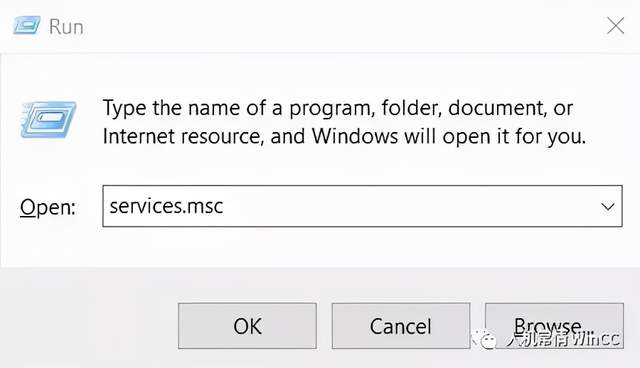

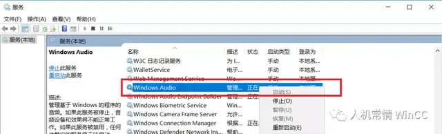

  • windows键+R,输入services.msc,打开windows服务界面

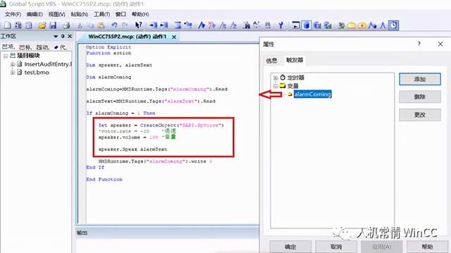

  • VBS全局脚本中调用SAPI接口播报消息文本,此脚本采用变量触发(内部变量alarmComing)。
Dim speaker, alarmText
Dim alarmComing
alarmComing=HMIRuntime.Tags("alarmComing").Read
alarmText=HMIRuntime.Tags("alarmText").Read
If alarmComing = 1 Then
Set speaker = CreateObject("SAPI.SpVoice")
speaker.rate = 0 '语速
speaker.volume = 100 ‘音量
speaker.Speak alarmText
HMIRuntime.Tags("alarmComing").write 0
End If
End Function
